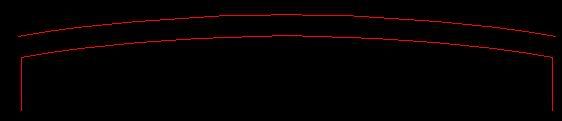

Đoạn code ma ban Binh sửa: (command "offset" o (setq arc2 (entsel "chon doi tuong:")) thay bằng (command "offset" o arc1 '(-1.5707 -60) ""). Máy khong hieu offset mot đoạn 20mm. Ban co the chỉ lai minh phan này. Con doan: (command "pedit" arc2 "y" "j" (ssget) "") (setq a9 (entlast)) (command "extrude" a9 "" h1) máy nó trả về : "Select objects:
3 segments added to polyline
Enter an option [Open/Join/Width/Edit vertex/Fit/Spline/Decurve/Ltype
gen/Reverse/Undo]: extrude
Invalid option keyword.
; error: Function cancelled". Khi ma minh zoom man hình thi phan offset no khong hiểu theo toa độ mình muốn:
Mong hồi đáp của ban Bình va các huynh....
;;;;bat dau hoc
(defun c:apo()
(setq p1 (getpoint "\ndiem chuan"))
;;; doi mau
(command "color" 1)
;;;;nhap khoang cach
(setq x (getreal "\nchieu cao:"))
(setq l (getreal "\nchieu dai theo truc x:"))
(setq h (getreal "\nchieu cao cung:"))
(setq o (getreal "\nkhoang cach:"))
(setq p2 (polar p1 (/ pi 2) x))
(setq d1 (command "line" p1 p2 ""))
(setq p3 (polar p2 0.0 l))
(setq p4 (polar p3 (-(/ pi 2)) x))
(setq d2 (command "line" p3 p4 ""))
;;;;ket thuc mot cai
(setq p5 (polar p2 0.0 (/ l 2)))
(setq p6 (polar p5 (/ pi 2) h))
;;;; ve arc
(setq arc1 (command "arc" p3 p6 p2 ""))
;;;; offset
(command "offset" o
'(-1.5707 -60) "e")
(command "zoom" "all")
(command "fillet" "r" 0 "")
(command "fillet" (entsel "\n Chon doi tuong 1")
(entsel "\n Chon doi tuong 2") "")
(command "fillet" (entsel "\n Chon doi tuong 3")
(entsel "\n Chon doi tuong 4") "")
(setq h1 (getreal "\nchieu cao doi tuong:"))
(setq a9 (entlast))
(princ)

Đoạn code ma ban Binh sửa: (command "offset" o (setq arc2 (entsel "chon doi tuong:")) thay bằng (command "offset" o arc1 '(-1.5707 -60) ""). Máy khong hieu offset mot đoạn 20mm. Ban co the chỉ lai minh phan này. Con doan: (command "pedit" arc2 "y" "j" (ssget) "") (setq a9 (entlast)) (command "extrude" a9 "" h1) máy nó trả về : "Select objects: 3 segments added to polyline Enter an option [Open/Join/Width/Edit vertex/Fit/Spline/Decurve/Ltype gen/Reverse/Undo]: extrude Invalid option keyword. ; error: Function cancelled". Khi ma minh zoom man hình thi phan offset no khong hiểu theo toa độ mình muốn: Hình đã gửi Mong hồi đáp của ban Bình va các huynh....
nguyên nhân là đây nè:
bạn bỏ "y" khỏi đoạn code đi là được

Mình bỏ thử nhưng đâu co khac j. Nó con hoi co yes hay no. Ban đã làm thử chưa?? giup thi giup cho chot nha ban. thanks bạn
Bạn ketxu minh có tìm biến sysvar peditaccept nhung khong thấy, ban co the giai thich ro hon duoc không?
Thú thật mình ko biết bạn bực mình hay sao àh? Ở đây mình góp ý vậy, có thể đúng hoặc chưa đúng. nhưng ko ai có ý chọc tức bạn hay là nói cho DZui đâu.
Bạn thay dòng code trên bằng cách thêm một "" ở cuối đoạn code. MÌnh thử và thấy OK.
(command "pedit" arc2 "y" "j" (ssget) "" "")
vì dấu nháy đầu tiên là kết thúc chọn dt, thêm một dấu để kết thúc lệnh!

Trời cuối cùng tui da lam hoan thanh. Thanks bác Bình, ketxu, lp_hai. Neu cac bác con thay nen sua phan gi nua. Dong gop cho minh them nha.
;;;;bat dau hoc
(defun c:apo()
;;; doi mau
(command "color" 1)
;;;; ve arc
;;;; offset
(command "offset" o
'(-1.5707 -60) "e")
(command "pedit" arc2 "Y" "j" (ssget "X") "" "")
(setq a9 (entlast))
(princ)

Lisp chạy thì đúng với yêu cầu rồi. Nhưng phần chọn đối tượng thì chưa ổn. Bạn đọc kỹ lại chỉ dẫn của bác Bình nha. Bạn chỉ làm theo lời bác ấy có một nửa thôi:
VD như bạn (setq d1 (command "line" p1 p2 ""))
mà ko ứng dụng thằng d1 này vào lệnh fillet, tương tự như đoạn:
(command "offset" o
'(-1.5707 -60) "e")
bạn lại phải chọn lại cái arc, trong khi đó bạn đã có nó là arc1
thì bạn phải sửa là:
(command "offset" o arc1 '(-1.5707 -60) "e")
(setq arc2 (entlast))
khi này bạn đã có arc2. Bạn hãy thay chúng vào lệnh fillet mà ko cần phải chọn lại dt:
(command "fillet" arc2 d1)
bạn thử xem thế nào
Hic (setq d1 (command "line" p1 p2 ""))
dòng lệnh này ko ổn rồi!
Phải là thế này:
(setq d1 (entlast))
như vậy nó mới hiểu d1

1/- (command "offset" o arc1 '(-1.5707 -60) ""). Máy khong hieu offset mot đoạn 20mm.
Cái ni bạn hãy chú ý cái tham số o. Theo cú pháp của lệnh offset thì o chính là tham số chỉ khoảng cách cần offset. Vì trong lisp của bạn đã có cái định nghĩa về tham số này rồi nên mình không định nghĩa lại nữa. Nếu bạn tách riêng đoạn code này ra khỏi cái lisp của bạn thì tất yếu sẽ không có cái tham số này. hãy kiểm tra lại nhé vì mình thấy cú pháp của câu lệnh này không sai.
2/- (command "pedit" arc2 "y" "j" (ssget) "") (setq a9 (entlast)) (command "extrude" a9 "" h1) máy nó trả về : "Select objects: 3 segments added to polyline Enter an option [Open/Join/Width/Edit vertex/Fit/Spline/Decurve/Ltype gen/Reverse/Undo]: extrude Invalid option keyword. ; error: Function cancelled".
Ấy là do cú pháp của câu lệnh này : (command "pedit" arc2 "y" "j" (ssget) "") chưa đầy đủ bạn ạ.
Lỗi là do mình không kiểm lại mà cứ nhớ phuong phưởng nó mà thôi.
Với câu lệnh này sau khi nó joint các đoạn lại thành một polyline duy nhất thì nó sẽ xuất hiện Enter an option [Open/Join/Width/Edit vertex/Fit/Spline/Decurve/Ltype gen/Reverse/Undo]
Thực ra như bạn thấy nó đã liên kết được thêm 3 đoạn (segment) mới rồi đó.
Tuy nhiên đáng lý ra phải có thêm một cặp dấu nháy "" nữa để lisp hiểu rằng mình chẳng muốn chọn thêm gì nữa và thoát khỏi lệnh pedit thì mình lại quên cái cặp dấu nháy này (cái cặp dấu nháy đã có trong lisp mới chỉ có tác dụng kết thúc lệnh ssget để chọn đối tượng chứ chưa có tác dụng kết thúc lệnh pedit) .Vì thế nó chưa thoát được khỏi lệnh pedit nên nó vẫn tiếp tục hỏi và chờ bạn trả lời.
Tiếp sau đó là lệnh extrude, lúc này lisp hiểu cái "extrude" này là tham số bạn chọn tiếp theo của lệnh pedit mà lệnh này lại chẳng hề có tham số nào như vậy. Thế nên mới có thông báo: extrude Invalid option keyword. ; error: Function cancelled"
Vì vậy với cái lỗi ngớ ngẩn này của mình bạn chỉ cần thêm một cặp dấu nháy "" nữa vào cuối câu lệnh trên để thành (command "pedit" arc2 "y" "j" (ssget) "" "") là mình tin nó sẽ khỏi bệnh mà.
Hề hề hề, thực ra do bạn mới làm lisper nên mới gặp khó khi thấy những lỗi này. Nếu thêm độ vài giờ kính nghiệm làm lisp nữa thì bạn sẽ dễ dàng nháy mắt với mấy cái lỗi ngớ ngẩn này ngay ý mà.
Thành thật xin lỗi bạn vì đã ngớ ngẩn.

Bạn không thể lấy đối tượng line kiểu này được đâu nhé. Khi mới học lisp cứ ngỡ vẽ line xong rồi setq là lấy được nó, nhưng không. Muốn lấy nó thì dùng (entlast) hoặc thay hàm command bởi entmakex

Các huynh đã quên khi fillet ta chọn đối tượng pick gần nhất nó mới kín được. không sẽ thành ra như vậy nè. Chờ hồi âm từ các huynh nhanh nhất.
Theo cách của bạn Bình mình bỏ O trong đoạn: 1/ (command "offset" o arc1 '(-1.5707 -60) "") thì máy nó bắt chon đối tượng và nhập khoảng cách offset. Lúc này càng phức tạp hơn. Ban xem lại thử nha.
;;;;bat dau hoc
(defun c:apo()
;;; doi mau
(command "color" 1)
(setq d1 (entlast))
(setq d2 (entlast))
;;;; ve arc
(setq arc1 (entlast))
;;;; offset
(command "offset" o
(entsel "chon doi tuong:")'(-1.5707 -60) "e")
(command "fillet" arc2 d1 )
(command "fillet" d2 arc2 )
(setq a9 (entlast))
(princ)
(setq a9 (entlast))
(princ)
Hề hề hề,
Trâu chậm uống nước đục. té ra bạn đã tìm được lỗi và tự mình hoán thành cái lisp theo ý bạn.

Đa tạ bác Bình đã chỉ giáo tận tình. Nhưng hiên tại mình làm theo yêu cầu của các huynh là không cần chọn đối tượng để fillet mà dùng lệnh : (command "line" p1 p2 "") (setq d1 (entlast)) để nhận diện line và arc. Nhưng nếu làm vậy thì bị lỗi giống hình mình đã post. Chờ các bác hồi âm....

Cũng như em nói ở trên. Lisp chạy thì OK nhưng cách chọn đt thì bị trùng lấp nhiều quá. Tỷ như chuyện chọn arc thì phải chọn 2 lần, setq d1 d2 mà ko để ứng dụng dc gì. Em có nói bác ấy là (command "fillet" arc2 d1) thiệt là bậy wá. Xin lỗi mấy bác!
Thành thử em đền cho bác ấy lisp sau. Cơ bản là như vậy như bạn chỉ cần nhập đầu vào một lần. Còn nhập chiều cao bạn có thể đem lên trên để cho lisp chạy cái một thì hay hơn.

Cách sửa của mình như sau:
tìm điểm p7 là điểm nằm trên arc2
sau đó extend cho đường d1 và d2 tới arc2 (cái này do em gà nên ko biết lấy điểm giao giữ 2 thằng này, bác nào biết chỉ giùm em luôn ah!! :) )
vẽ lại arc2 theo 3 điểm là điểm đầu d1 diểm p7 và điểm cuối của d2
lệnh pedit khi này không cần chọn đối tượng mà lisp tự gom arc1 arc2 d1 và d2 luôn

Đúng là cái thằng fillet này cũng hơi oái oăm. Theo ngu ý của mình thì cái lỗi ni có nhẽ do cái biến x của bạn hơi bị ..... thừa. Bi giờ bạn thử nhập giá trị biến x bằng với giá trị của biến o coi sao nhé.

Trước hết thanks bác lp_hai. Nhưng minh sử dụng lisp đó nó đâu có tạo thành 1 biên dạng kín đâu. Bác xem lại giúp nha.....

bạn test lại thử xem! Mình mới áp dụng cách lấy điểm giao nhau giữa 2 đường. Bạn nhớ thanks 2 bác ở trên luôn nha!
