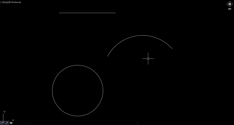

    (defun c:tt  (/ lst pol ssx)
      (if (and (setq ssx (ssget)) (setq pol (car (entsel "\nPick chon curve: "))))
        (progn (setq lst (vl-remove pol (vl-remove-if 'listp (mapcar 'cadr (ssnamex ssx))))
                     lst (vl-remove-if-not '(lambda (x / o)
                                              (and (vlax-method-applicable-p (setq o (vlax-ename->vla-object x)) 'intersectwith)
                                                   (vlax-invoke (vlax-ename->vla-object pol) 'intersectwith o acextendnone)))
                                           lst)
                     ssx (ssadd))
               (foreach e lst (setq ssx (ssadd e ssx)))
               (sssetfirst nil ssx)))
      (princ))
