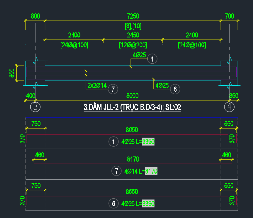

  2. Vào lúc 6/7/2021 tại 07:39, DungNguyen685 đã nói:
    ;;----------------------=={ Length at Midpoint }==----------------------;;
    ;  This program prompts the user for a selection of objects to be      ;;
    ;  labelled and proceeds to generate an MText object located at        ;;
    ;  the midpoint of each object displaying a Field Expression           ;;
    ;  referencing the length of the object.                               ;;
    ;  The program is compatible for use with Arcs, Circles, Lines,        ;;
    ;  LWPolylines, 2D & 3D Polylines, and under all UCS & View settings.  ;;
    ;  The program will generate MText objects positioned directly over    ;;
    ;  the midpoint of each object, and aligned with the object whilst     ;;
    ;  preserving text readability. The MText will have a background mask  ;;
    ;  enabled and will use the active Text Style and Text Height settings ;;
    ;  at the time of running the program.                                 ;;
    ;  Author:  Lee Mac, Copyright © 2013  -  www.lee-mac.com              ;;

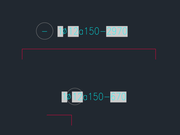

    Các bác cho em hỏi thêm là khi em dùng lệnh tcout để đánh số thì cái mtext không áp dụng được, phải explode nó ra mới được
