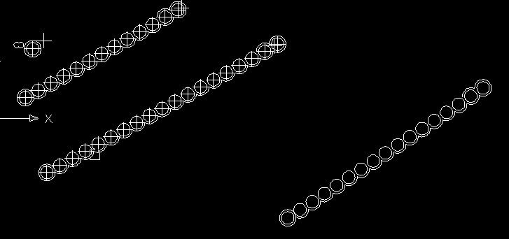

Có tí code nghịch vui. Bác nào rảnh hoàn thiện nốt cho ra kết quả ^_^
(DEFUN c:test (/ *error* cen d gr loop p1 foo foo_1 line circle1 circle2 lst_1 lst_2) (DEFUN *error* (msg) (MAPCAR '(LAMBDA (o) (VLA-DELETE (VLAX-ENAME->VLA-OBJECT o))) lst_1) (MAPCAR '(LAMBDA (o) (VLA-DELETE (VLAX-ENAME->VLA-OBJECT o))) lst_2) (AND line (ENTDEL line) (SETQ line nil) ) ;and (OR (= msg "function cancelled") (PRINC (STRCAT "\nerror: " msg)) ) (PRINC) ) (SETQ cen (GETPOINT "\nChon diem 1: ") loop T ) (SETQ d (GETREAL "\nChon duong kinh: ")) (IF (NOT d) (SETQ d 6) ) (WHILE (AND (SETQ gr (GRREAD T 12 0)) loop) (COND ((= (CAR gr) 5) (MAPCAR '(LAMBDA (o) (VLA-DELETE (VLAX-ENAME->VLA-OBJECT o))) lst_1) (MAPCAR '(LAMBDA (o) (VLA-DELETE (VLAX-ENAME->VLA-OBJECT o))) lst_2) (SETQ lst_1 nil lst_2 nil) (AND line (ENTDEL line) (SETQ line nil) ) ;and (SETQ p1 (CADR gr)) (SETQ foo (/ (DISTANCE p1 cen) d)) (SETQ foo_1 (ATOI (RTOS foo 2 2))) (IF (> foo_1 1) (PROGN (SETQ lst_1 nil lst_2 nil) (SETQ line (ENTMAKEX (LIST '(0 . "LINE") '(100 . "AcDbEntity") '(100 . "AcDbLine") '(62 . 6) (CONS 11 p1) (CONS 10 cen) ) ) ;entmakex_line ) (SETQ circle1 (ENTMAKEX (LIST '(0 . "CIRCLE") '(100 . "AcDbEntity") '(100 . "AcDbCircle") '(62 . 6) (CONS 40 (/ d 2)) (CONS 10 cen) ) ) ;entmakex_circle1 circle2 (ENTMAKEX (LIST '(0 . "CIRCLE") '(100 . "AcDbEntity") '(100 . "AcDbCircle") '(62 . 6) (CONS 40 (+ (/ d 2) 1)) (CONS 10 cen) ) ) ;entmakex_circle2 ) ;setq (SETQ lst_1 (CONS circle1 lst_1)) (SETQ lst_2 (CONS circle2 lst_2)) (SETQ p1a (POLAR cen (ANGLE cen p1) (+ d 1))) (REPEAT (- foo_1 3) (SETQ circle1 (ENTMAKEX (LIST '(0 . "CIRCLE") '(100 . "AcDbEntity") '(100 . "AcDbCircle") '(62 . 6) (CONS 40 (/ d 2)) (CONS 10 p1a) ) ) ;entmakex_circle1 circle2 (ENTMAKEX (LIST '(0 . "CIRCLE") '(100 . "AcDbEntity") '(100 . "AcDbCircle") '(62 . 6) (CONS 40 (+ (/ d 2) 1)) (CONS 10 p1a) ) ) ;entmakex_circle2 ) ;setq (SETQ p1a (POLAR p1a (ANGLE cen p1) (+ d 1))) (SETQ lst_1 (CONS circle1 lst_1)) (SETQ lst_2 (CONS circle2 lst_2)) ) ;repeat ) ) ;if ) ((= (CAR gr) 3) (SETQ loop nil)) (T (MAPCAR '(LAMBDA (o) (VLA-DELETE (VLAX-ENAME->VLA-OBJECT o))) lst_1) (MAPCAR '(LAMBDA (o) (VLA-DELETE (VLAX-ENAME->VLA-OBJECT o))) lst_2) (SETQ lst_1 nil lst_2 nil) (AND line (ENTDEL line) (SETQ line nil) ) ;and (SETQ loop nil)) ) ) (PRINC) )
Sao của bác Mạnh ket thấy chỉ có preview thôi nhỉ ^^ Ấn j để ra kết quả ta
Chưa hợp lý với n = 1 và UCS khác world
Ps : code 28k chắc bác ôm LM osnap của Grread + LM:Grtext vào hén :)
Thiếu case (= (car gr) 3)) ^_^ là ra kq. ;)
