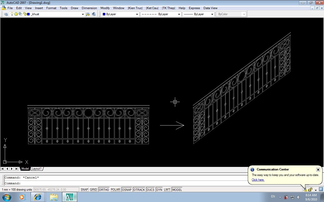

Hi i find this code in this site https://www.cadviet.com/forum/topic/13203-viết-lisp-theo-yêu-cầu-phần-2/?page=68. The project started by phamngoctukts . Is any one finish this code? Can any one help?
Thanks

Hi bro, try this (in the same link) . Ken you sờ pik Vietnamese ?
;; free lisp from cadviet.com
;;; this lisp was downloaded from https://www.cadviet.com/forum/topic/13203-vi%E1%BA%BFt-lisp-theo-y%C3%AAu-c%E1%BA%A7u-ph%E1%BA%A7n-2/?page=68
